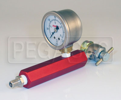

We're about to buy one of those special pressure gauges for the shocks, so we don't have to keep using Henry's. Just wanted to see what others are experiencing. We've checked the reservoirs two or three times in the last six months. Both times they've needed added pressure. When we have our own gauge we can check before each event.

Mako--The most common nitrogen leal would be at the schrader valve. Spit , water or soappy water will all do the trick. The o-rings that seal the cannisters hardly ever need replacing or leak. I can't remember for sure, but I don't think we replaced any of your seals before, except one shaft seal? Buying the correct tools, is always a good decision. Guy

How much are they leaking? From what to what? Attaching the pressure tool will give you a lower reading as it's got a small chamber that needs to get filled (depending on the tool, the delta will be different). Using anything that doesn't allow the valve to close before the pressure is released is unreliable (advantage Presta).Mako Koiwai wrote:We're about to buy one of those special pressure gauges for the shocks, so we don't have to keep using Henry's. Just wanted to see what others are experiencing. We've checked the reservoirs two or three times in the last six months. Both times they've needed added pressure. When we have our own gauge we can check before each event.
