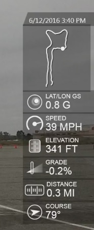

The lateral g-force display has been smoothed out a lot in a later version of the software since that video was shot.
To confirm, here is a snapshot showing what data you get from a Virb XE, by default, without any OBD2 dongle attached.
Now, what exactly is the Auto Racing Bundle and what do you get.
Obviously the Virb XE camera. This is the same as just buying the regular camera. It's the same exact model and accessories.
In addition to the camera, you get an OBD2 dongle, a suction mount, and a 16GB memory card.
The ODB2 dongle is a re-branded Scantool OBDLink MX, however it will not work with the Scantool application. What there is to note here, is that this dongle is no different from any other Bluetooth dongle in that it uses the ELM327 standard protocol, which means that any other ELM327 Bluetooth dongle can communicate with the camera and record the data including home-built units for vehicles that don't have OBD2 ports.
Lastly a couple of warnings, mentioned earlier. Even though the camera uses the standard ELM327 protocol, this does not guarantee that the camera will record the data correctly. I actually have the Auto Racing Bundle and can connect to the camera using either the Garmin branded Scantool or a generic BT dongle off eBay. However, neither record data, but both work perfectly with Torque. There are also threads on Garmin's forum that document the various successes and failures of different vehicles to connect. In all cases it seems like it's the vehicle that dictates this, not the dongle used, despite the fact that they are all ELM327 based. I have successfully recorded data from my wife's Prius using both dongles.
Also, I think the battery life leaves a little to be desired. I have only been able to get around 90 minutes out of a fully charged battery. This time is only dependent on the camera being turned on. There appears to be no difference in usage between actual recording and stand-by mode.
