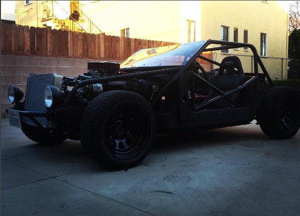

I have a street legal registered 1984 Corvette with stock suspension, numbers matching engine bored to 355 and Contiental Extreme Contact tires. The curveball is an exceptionally large weight reduction - the body has been removed and the car is caged. I would appreciate understanding what class this fits into and if no class works, could I still attend practice days?
Thanks,
Ryan
