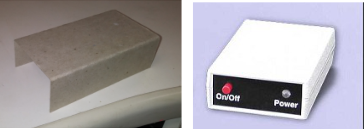

I've used something like this to be a weather cover/sun shade over sensors in a previous life.. helps keep the sun from hitting the eye directly.
https://www.amazon.com/Cantex-Pvc-Sch-C ... uit+bodies
with a little looking they can be found with wing nuts which are easier to deal with than screws.

The reality is it's not really an issue, rarely happens and just a matter of noticing where the sun is and which way the light is aimed. If there is a potential issue, we simply swap the sensors at lunch time. We just forget sometimes.
Or there's this (attached with a rubber band):
