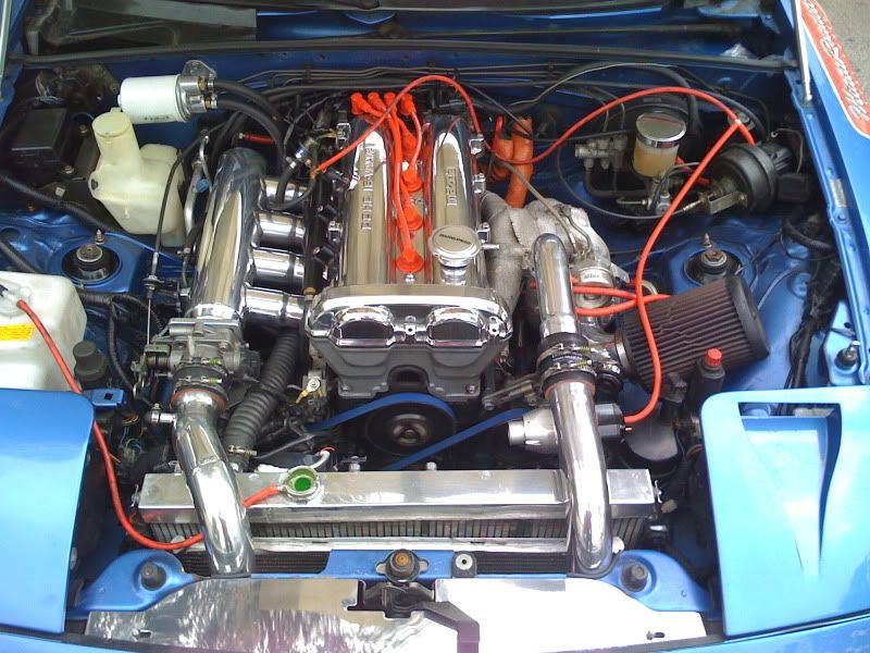

I wanted to ask if anyone has experience with warranty clams with Garrett.
I got a new ($1100) GT2560 about six months and 3K miles ago and I noticed that it's been leaking oil from the seals. More specifically the BOV (which is placed at the turbo side before the IC) is squirting oil and the air intake (before the turbo) has also oil!
Check out this pictures to get an idea of what I'm facing...

I take it you're sure it's not from the PCV/Crank Case venting system. Every turbo car i've had's intake pipes look about like that from the oily vapor being vented from the crank case/valve covers. Though maybe not quite as bad, not far off.
Re: My new Garrett GT2560 turbo (~3K miles) is leaking oil - Any
I think you're right about the leaky seals. But as Aaron was saying, every turbo car I've had too sucked/blew oil out the crankcase. Sometimes plumbing in an oil catch can to the PCV path will help reduce oil being sucked into the intake path.

Don't assume anything 8-) but I did installed an oil catch can a week before noticing this but of course I didn't clean the pipes - so the oil might have been there... I think I'll need to check that out - thank you for your comment Aaron!

Wow I had no clue Steve... :shock: - I never check my Saab Aero and it was too old anyways to care about leaks... I'll try create a isolation box for the intake to make sure that engine breaths clean air and I'll check again....The oil catch can is already in place so these two things should reduce or even eliminate this condition if the problem is not at the seals...

Looking at the amount of oil in your compressor inlet, I would guess that it is coming from the engine PCV system. The compressor inlet ducting is before the turbo, so there can't be any turbo seal leakage oil there.
You also have a lot of oil in your compressor outlet ducting. That could be from a seal leak at non boost conditions when you have engine vacuum there. But with all the oil in the compressor inlet, I would bet that the compressor out oil is just from oil passing thru the compressor from the inlet.
Your PCV valve probably dumps its oil vapor into the inlet in front of the compressor inlet. How old is the PCV valve? I'd start by replacing it and cleaning out all the intake ducting. Then run it a while and check again.

Does it still boost? Do you have an oil restrictor on the oil inlet to the turbo?

Todd Victoria wrote:Does it still boost? Do you have an oil restrictor on the oil inlet to the turbo?
It does boost strong, I don't have any oil restrictor on the inlet to the turbo.

Thank you John, I think what you say it makes sense... the PCV valve I believe it's new, but I'll clean the pipes and see if the problem is still there.

Without an oil restrictor the oil pressure can definitely blow the seals in the turbo. Did you check the shaft play
of the compressor wheel?
