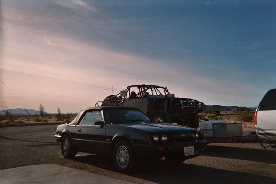

Ok I have this completely stock 1985 convertable mustang.
I ask this from a completely newbie side of things, I've never even been to an autocross event.
I've been telling myself for years that I'm gonna get into it & just never have. :roll:
What about personal safty gear?
do I need a race suit & helmet?
I already have both being I'm into the Off Road racing thing. :thumbup:
I assume that I will need at least a 4 point roll bar & a Battery hold down?
But what else might I need?
I assume I could start in the stock class & then work my way up as my skills improve.
Right now the car has a worn out stock suspension, & I wonder how easy it will be to accidently modify myself into a class I have no chance in.

& My Convertable Mustang stats are
1985 5.0/302 engine
5 spd trans
4 Bbl carb
I'm not sure what else you might need to know? Image

Nice stable of off-road machines. The Sammy is the one nobody outside of off-roading knows about and makes the Hummer look almost as ridiculous as it is on pavement.
