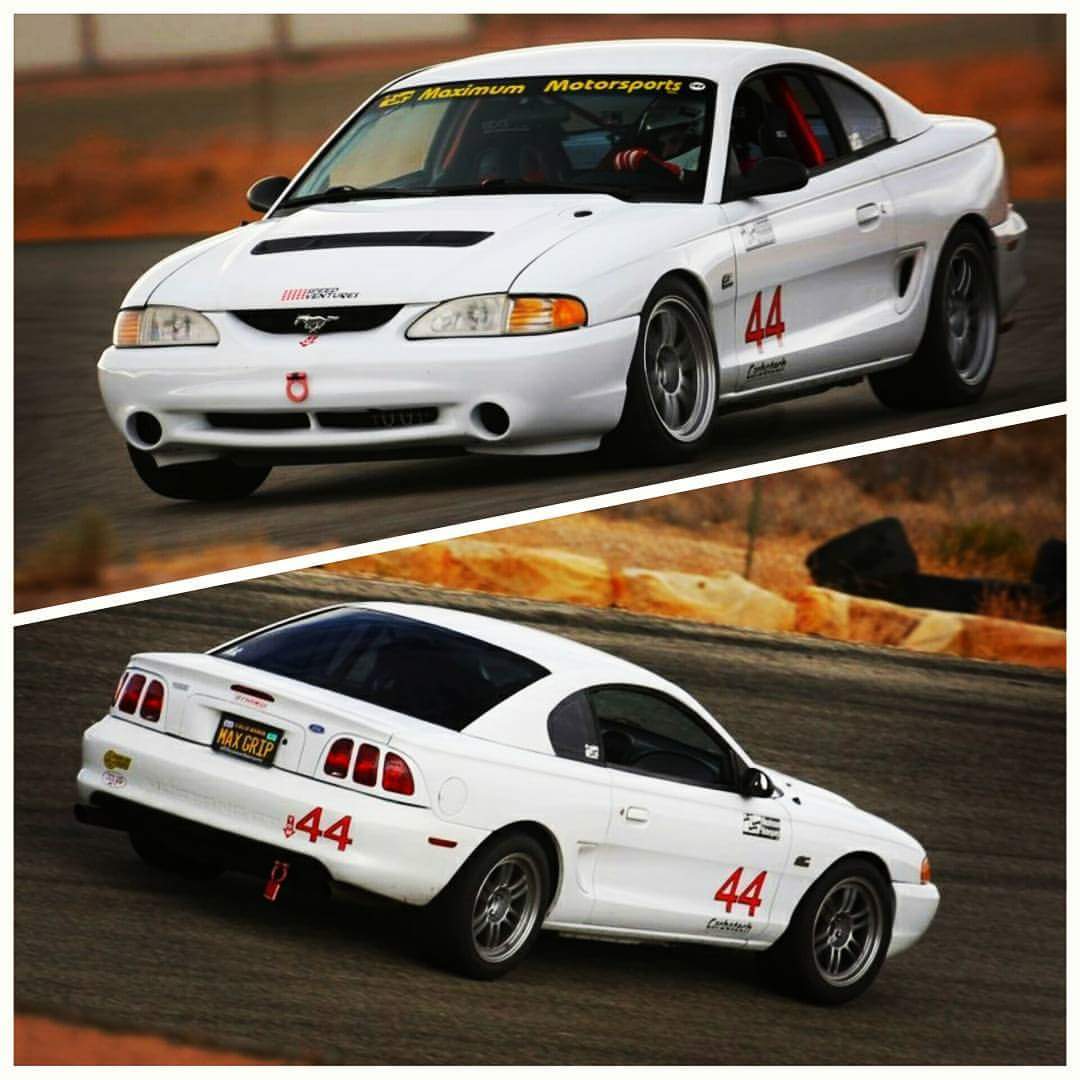

Honestly, I haven't been planning on getting into autox. I've done it a few times with other outfits mainly to tune my actual race car, and decided to try it in my recently purchased daily as well. Honestly, I've seen what FS is like in my region, and I might actually have a pretty solid chance against the cars here. I was 2 seconds adrift of fastest car in non PAX FS, and I was on 340tw tires. With the bigger front sway bar and good 200tw tires, I should be able to close that gap.
My other car is this
