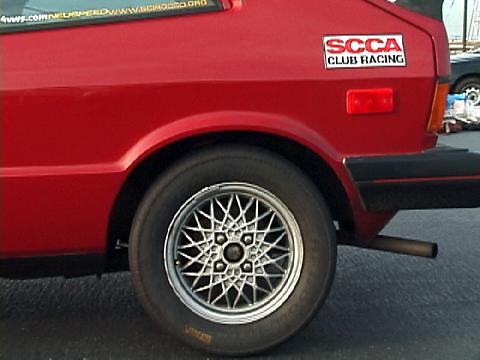

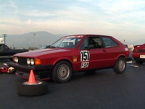

This is some pictures of my old old old Scirocco from a long time ago on 6 in wheels.
(This is not the really nice red car that some of you remember, it is a different one)
Doug T
