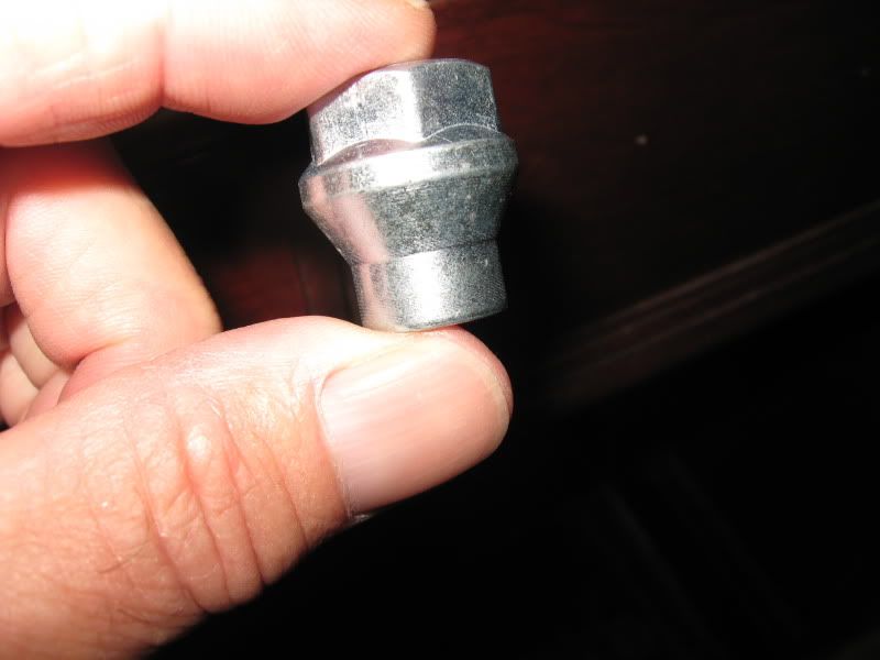

Re: Need a couple of '03 Z06 lug nuts (M12 1.5)
Lug nut should have a bulge or you will "drill" into the c5 rim.
http://i125.photobucket.com/albums/p70/ ... G_1616.jpg
Above has the bulge AND threaded shank, whuch I prefer. Lot more thread engagement.

The problem with the Miata nuts ended up being that it didn't have that collar like the Vette one on the left. The temporary Miata one was OK for the few runs today. Replacing with oem soon.
- VetteVsMiata.jpg (115.33 KiB) Viewed 4180 times
In the lug nut business they call it the bulge. Just so if you order some online from a source who knows the product, they will understand what you need.
